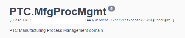

Hi @AS_10652879
Check PTC Manufacturing Process Management Domain, all APIs what you need are there
PetrH
Hello AS_10652879,
Can you review Windchill Help Center > PTC Manufacturing Process Management Domain ?
Also kb article CS404200.
KR,
Charles.
