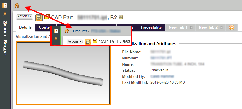

The 'breadcrumb' has vanished.
The link appears correctly in Edge, Firefox, and Brave.  Below is a screen shot showing the 'breadcrumb' missing in Chrome, but correct in other Browsers.

(To:JHall)
Every time I've lost the breadcrumb links, I clear the cache in Chrome and restart the browser. Almost always takes care of this issue. Appears to have corrected the issue on WC 11.1 M020 CPS11 with Chrome Version 83.0.4103.97
