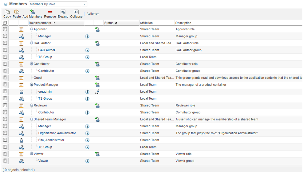

One of the constructors has a problem with rename part. He has the same privileges and is in the same groups/roles but rename option is greyed out. Where did we suppose to look to fix it? It is urgent.

You said "One of the constructors has a problem with rename part." Did you really mean "constructors" or did you mean "contributor" like in the image you show.
If you did mean contributor then I assume both users are in that role?

@LawrenceS As I mentioned at the beginning it doesn't work only on one user account. They have the same roles etc. but we need to find the problem. They compare creo settings and found out that it works for ie_explorer but not on chromium. They changed it to ie and finally, it works. I don't know why occurs this error.
