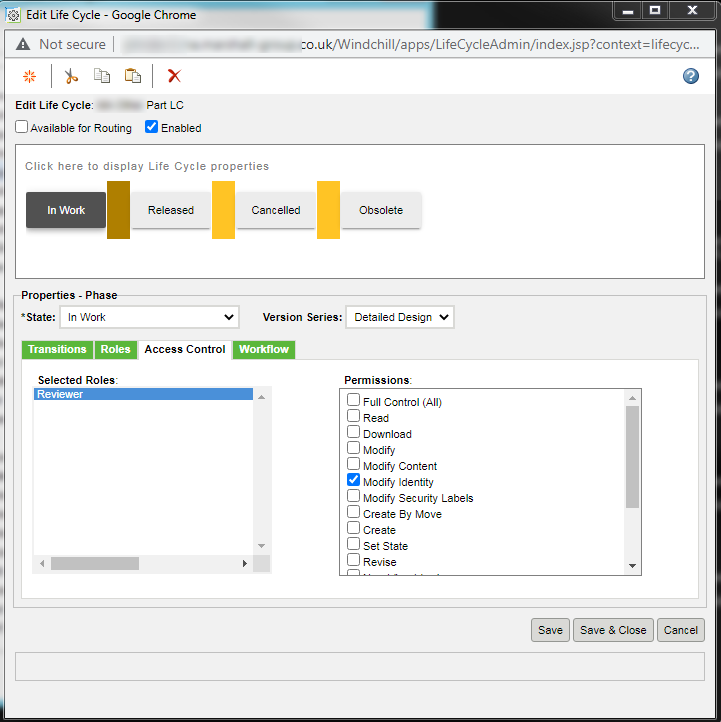

I have multiple products in my Windchill 11.1 M020 CPS20 system. In one product, the designers can rename CAD files and change the Name, Number and File Name with no issues. in a new product added after we upgraded to Windchill 11.1, they cannot rename files. I have checked the ACL lists and they are identical between the 2 products. What else can cause the rename File Name and Number fields to be greyed out.

PTC Tech support showed me where I was looking at the wrong participant listing. I thought it was the Designer role, but it was actually the Member role that needed updating by adding the Modify Identity ACL permission to the EPM Document, Document and Part object types at the Design state. I will have to do some more checking to be sure that my other states and roles are in agreement.

Perhaps some Ad-hoc permission in the life-cycle template is causing a conflict?
Not sure what that would be though and it's not easy to see which version of an LC template a particular object is using.
Marco_Tosin
(To:rhart)
You can use this report to verify the version of LC in use for your CAD documents
Marco
BenLoosli
(To:rhart)
Lifecycle was last modified in June 2020, everything new would be using the same lifecycle.
