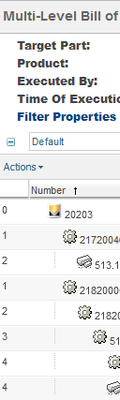

This is OOTB multi level BOM
Marco

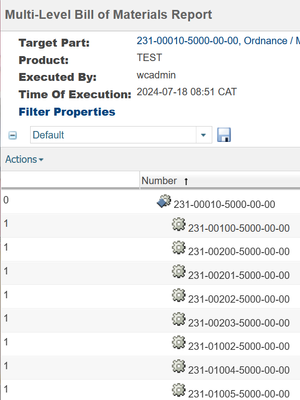

That is exactly what I am looking for but my OOTB does not want to do that. Could you please advise or guide me on how I can generate such a report.
I only get top level and 1 level down. See below.

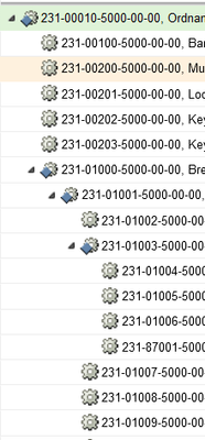

I have also attached what it looks like in Structure View but I need it a a report.
