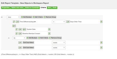

I had a similar issue, but a different approach. I made a report to query New Objects in Workspaces that hadn't been checked in. The report is a little more complex than probably needed because it returns both WTParts and CAD files. The report has a parameter so you can choose to only return items that have been sitting for over X days.

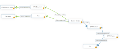

Here's what the tables and joins look like:

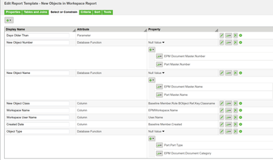

Select or Constrain:
And then Criteria:

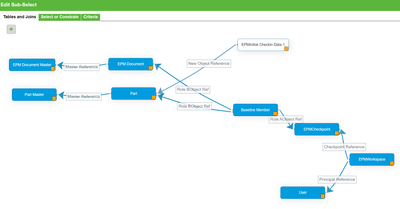

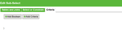

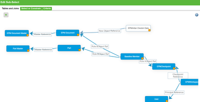

The Or condition has 2 sub-selects. It's been so long since I made this, I don't actually remember why this works. The first one is for returning CAD:
The 2nd is highly similar, but for the WTParts:
In practice though, what I've found is that engineers have a ton of abandoned files, and they don't like to clean up after themselves. I've stopped using the report entirely
And then Criteria:
