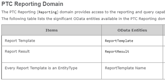

I want to retrieve maturity history and Lifecycle History of a document. How can I do this ? I did not found any endpoints in OData rest API.

Hi @EG_10925009
You need to use an template report RestApi to call the report inside the Windchill.
In the Windchill you need to create report template that return what you need.

Hi @EG_10925009
You can use rest api to run any report template in the Windchill so yes the endpoint has already exists there..
You just need to create a report that retrieves the information you need in the Windchill
/Windchill/servlet/odata/Reporting/ReportTemplates('OR:wt.query.template.ReportTemplate:334133')/PTC.Reporting.ExecuteReportTemplate
check Windchill odata documentation
/Windchill/netmarkets/html/wrs/doc.html

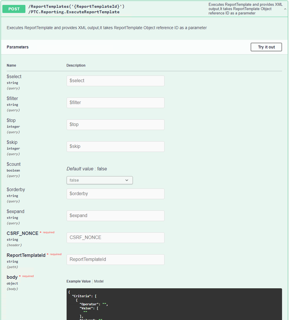

Thansk for answers. that's probably the solution. My company did a lot Report and   I can see that in odata rest api but all endpoints return 500 error. Other basic domains and enpoints is working bu just doesnt work report endpoints of my company. How do I fix this ?

Hi @EG_10925009
Who knows, It is just documentation the restapi works or contact a support to solve it.

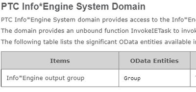

btw use the IETask end point instead of the report one.

Hi @EG_10925009
There is something wrong in the code that something is null and I guess it is a specific version bug.
In windchill 12.1.2.0 the report documentation page works.
btw the RestAPI works even though the documentation page can not loaded
here is an example from the documentation
curl example for you
curl -X 'POST' \
  'http://windchillServerXY:80/Windchill/servlet/odata/v1/Reporting/ReportTemplates('\''OR%3Awt.query.template.ReportTemplate%3A334133'\'')/PTC.Reporting.ExecuteReportTemplate?%24count=false' \
  -H 'accept: application/json' \
  -H 'CSRF_NONCE: CSFRNONCESTRING' \
  -H 'Content-Type: application/json' \
  -d '{
