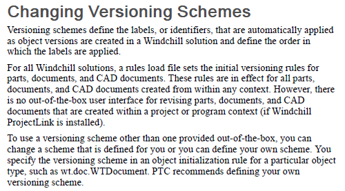

So I recently upgraded my test server from 10.1 m040 to 10.2 m020. I started testing stuff and came across something that is not a big deal from the big picture but a little disturbing that it would even happen, unless I've missed something that I need to do.
In 10.1 when I revised an object it would go from revision 2.2 to revision 3.0. In 10.2 when I just tried it, the revision went from 2.2 to 3.1. Is this normal with 10.2? What happened to iteration 0? Is there a preference for this?
It's due to your first iteration, not the Revision Series.
This property has the value 1 OTB; need to change to 0.

I think the series is referenced in your OIR. Let me see if I can find it...
TomU
(To:TomU)
Yeah, whatever custom versioning scheme you were using on 9.1 needs to be loaded into 10.2.
A sample is shown in the knowlege base here:
https://support.ptc.com/appserver/cs/view/solution.jsp?n=CS23066
Another discussion here:
https://support.ptc.com/appserver/cs/view/solution.jsp?n=CS53009
Fully documented in the Specialized Administration Guide

There isn't a "property migrator" but one can fairly easily take all the properties in site.conf created / modified after install and dump them into site.conf on the target and then just xconfmanager -p. This needs to be a key part of the upgrade process, not explicitly addressed as a "how-to" in the guides.
Note: If you do in fact have a custom Revision (version) series, then all the above applies. Need to be super careful to not overwrite what you intend to upload. The -read execution has to be to a different filename.
