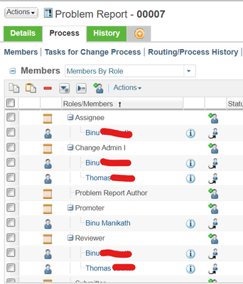

I have the following problem, when I start as an orgadmin I create a Text Document and start the Problem report. When I look in the Problem report workflow i ve put as Change Admins I 3 participants: orgadmin, user A and user B. I sign in as user A i can see the problem report but can't approve the same as user B. I can approve only as orgadmin. For user A and B the routing options are grayed out so they can't bring any decision like Fast track approval, clarify, reassign etc... but i want also approve as user A and user B why is that not possible?

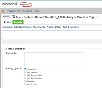

as site admin and orgadmin i can approve any report, as Binu i can see the problem report but the routing options are grayed out
for this problem report like in picture, i can approve as site admin and as org admin but not as Binu eventhou i gave him all the rights

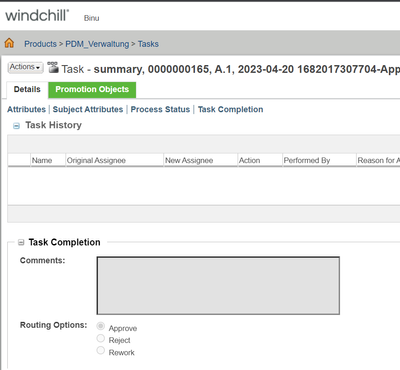

I have tried something else insted approving problem report, I've tried to approve a promotion request it seems thats the same problem as with the problem report I dare to say with all approvals (see pic)

Hey Marco i've solved the problem, the solution is as follows: I deleted the organisation from the users accidently so they are not participating in a organisation so they don't have routing options shown in picture:
