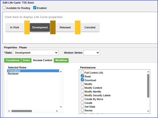

Did you think about using lifecycle based access control?
For example: deny the download permission (policy admin level) and grant 'download' for some role for some lc state.
Like below:
