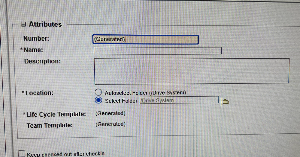

Description:
My request is to set autonumbering for objects while giving the user the ability to modify, for that I'm following this article How to Turn on Autonumbering for CAD document but also allow override the number during Save As or Rename in Windchill PDMLink.
This is working and Windchill shows the label Generated, my question is it possible to let the user sees this number (during creation)?
Because the user can modify the number, it's worth letting him see the one generated to decide whether to modify it or not.

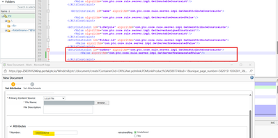

Fadel
23-Emerald I
(To:tarik_p)
Si Traik,
Set OIR as below
<AttrConstraint id="number" algorithm="com.ptc.core.rule.server.impl.GatherAttributeConstraints">
	       	   	   <Value algorithm="com.ptc.core.rule.server.impl.GetServerPreGeneratedValue"/>
</AttrConstraint>
Fede
tarik_p
(To:Fadel)
@Fadel It's working and the same number showing is the one taking after creation.
Thanks Mr. Windchill 🫡 !
