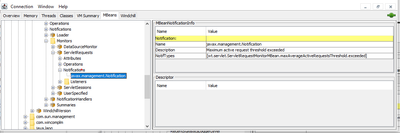

Windchill Server Status provide a lot of useful information about the health of the System.
Is it possible to setup a JMX notification when the Average Response Time is Red.

Yes, I setup the JMX Administrators and I do receive email notifications.
I was inquiring about setting up a custom JMX Notification based on another attribute; similar to the OOTB notification below:
"Maximum active request threshold exceeded."
