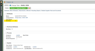

Hello dear community,
I want to reflect an attribute I use in the change task to the change notice to which it is linked.
I think I should use an alias attribute for this, but when I try it I get an error.
The attribute named WORKDAY is selected in the change task and I want it to appear in the primary attribute in the change notice.

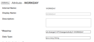

In the article on support, it is written that you should use the "wt.change2.WTChangeActivity2" method for the change task.
The MAP I tried in the Alias ​​attribute is as follows;

use below mapping :
theChangeOrder2@wt.change2.IncludedIn2~theChangeActivity2^wt.change2.WTChangeActivity2~WorkDay
CN :
CT :
Alias :

Thank you very much, great solution and explanation.
