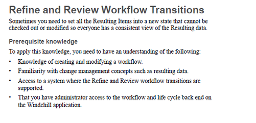

How do I use a robot to set the state of my resulting objects back to In Work.  The Lifecycle only allows the transition from In Work to Under Review, but on a rework loop they need to be set back to In Work to be updated.

First you should know how the Lifecycle works and how is it configured . Usually it depends on company needs.
You can modify Lifecycle template to allow users to change the state from one state to another .
Also a revise operation usually set the state to inwork for modifying the object with new revision.
Customization guide describes some customization of workflow for rework task
/WindchillCustomizationGuide_12_1_0_0 page 1314

Thank you, I was able to add a Refine and Review transition to the workflow and a Rework State for the transition.  It worked beautifully!
