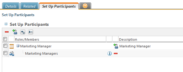

Except now when the Set Up Participants is done, it only shows the group, not the members of the group. The auditor pointed out that it was much faster and easier if every member is listed and he just picks the remove icon for the unwanted participants. Now he has to pick add and type in the username.
Is there a way to allow me to use a group on the context's Team page (for easy updating) yet still list every member of that group in the Set Up Participant page?
Here is what I see now. Previously it would show all the people that could be given the next assignment.

I am interested in this as well.  Our users are in Groups and we need to select individuals.  We are still in 9.1 but soon migrating to 10 and we see this as in issue.
Maybe remove a "layer" by using the Group (Marketing Managers in your case) as the resource pool for the WF Assignment?  Where this would fall down is if you had the Group + 1 or more additional Users within the Role on the Context team
Plus all my ACRs are set up for the roles, not the groups.
You could do both though... Group in Context Team Role for ACR's and Group as Resource Pool for Set Up Participants.  Seemingly redundant, but could work, no?
Ideally, Set Up Participants would be smart enough to see through to the WTUser rather than stop at the Group... (unless/until a bigger customer decides they want to assign Groups or Orgs using Set Up Participants)
