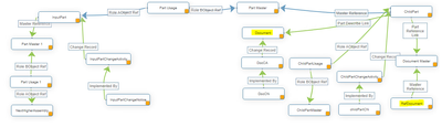

You are trying to do something that is not possible, see support's response to a request same as yours.
Is it possible to have single Query Builder report to fetch Described By Documents and Reference Documents of the WTPart in Windchill PDMLink?
Marco
What is the query you are using?
In Reporting, this should be possible by writing the query accordingly to check if its either of the two and then display it in the report column along with the link type (Desc. by or . Reference Doc).

My QML is as below
How can I add the criteria or different joins? So that I can get the reference and describe docs in single column.
If you want some more details, Please let me know.
