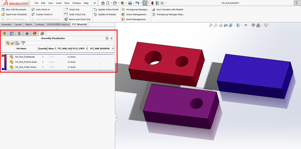

TomU
(To:mikebuchter)
Yes, a quick search shows this is possible via "Assembly Visualization".  Just add additional columns for whatever attributes you're interested in.
mikebuchter
(To:TomU)
How did you get those columns to show up?  When I "Add Columns" is only adds Total Weight, Mass, Density, Volume, is does not give me an option for any other columns.
