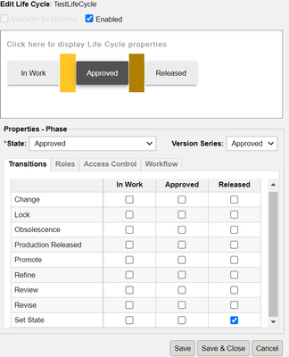

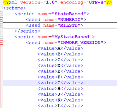

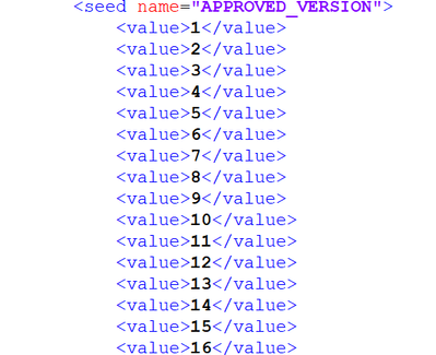

I have created a custom Versioning Scheme which should work with State Change from Approved -> Released ( i.e A.1 (Approved) will change to 1.1 (Released) State change either manually or when triggered in custom Workflow)
Has anyone encountered such issues, as this custom versioning is working for Object Revise action but not for Set State action / in Workflow State Change
Your support is appreciated. Thank you.
Lifecycle Transition:
where highlighted series is my Custom versioning Series name

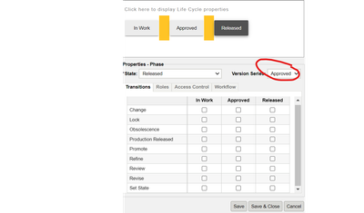

Hello @RB_10356553
The versioning schema is change only during Revise action.
Set state do not change it also Promotion do not change it.
You can set autorevision during Promotions request that the object is autorevised and then the versioning schema is changed.

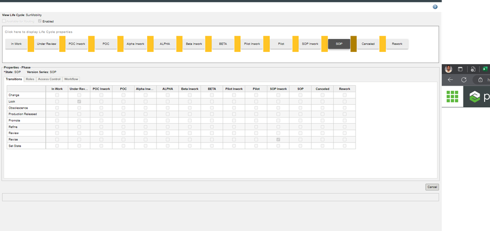

Hi Helesic,
   If we use Automatic Revision Mode it will automatically revised and version is changed. from inwork to released (SOP)
but in lifecycle we marked Revise for inwork(sop inwork), so at that time state is also changed to inwork (sop inwork) not to released
(SOP)
kindly share your idea.

Hi @Boopathy
This is a way how it works.
 Auto Revision is activated in the target promotion state, and how the revision is set then the new revision is in the target revise state.
So if you need that the autorevision finish in the SOP state, then you need some midle state where the promotion promote the objects and autorevision is activated and the result new revision will finish in the SOP state.
