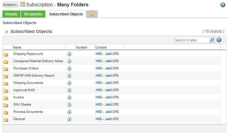

Windchill does allow you to subscribe to many items as once. For instance, you can select multiple folders (at the same level) then pick Subscribe from the Actions menu. The sad part is there is no way to edit the list of subscribed objects later. You can see the list of subscribed objects, but you cannot edit it. Sad. I was hoping to make a team subscription and just update it when ever new folders are created, but I would have to delete the subscription and recreate it every time.
This looks like 10 minutes of work for PTC R&D. Just need std edit functions added to this table.
