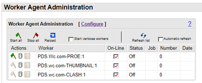

Hi Guys,
I started my CAD worker and it's working fine. I created same like this for Thumbnail Publish. But I didn't know how we can start this and which allowlist or whitelist to use for it.

More details:
Here ProE is a CAD worker
Thumbnail worker publishes PVS.
I run this comment to activate CAD worker. (Flag turned into Green)
<Property name="worker.exe.whitelist.prefixes" overridable="true"
targetFile="codebase/WEB-INF/conf/wvs.properties"
value="C:\ptc\WC_Workers\Creo|nohup /ptc/WC_Workers/Creo"/>
How we can do the same thing for Thumbnail Worker.
Aj

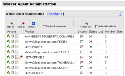

Whitelist setting applies for all workers I believe. You can create multiple acceptable paths but separating by a pipe character |. Looks like you are doing that already. Strange, looks like you have a windows and unix path listed.

After I added into Site.xconf, still thumbnail flag is executable not safe.

Can you list the paths to your command lines for each of your workers? It should be specific enough to make it secure while still functioning. Basically, this is specifying allowed startup commands since bad actor could use worker agent UI online to invoke commands on a remote cad worker machine.
