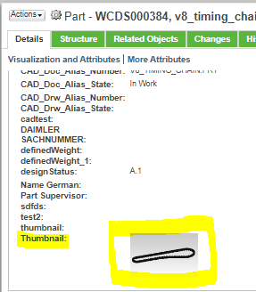

I am using Windchill PDMLink Release 11.2 and Datecode with CPS 11.2.0.2
Thumbnail attribute is added to Info page layout. This is supposed to be added in reports.
Its working on VM with demo data, but not on any server where visualization is generated through workers.

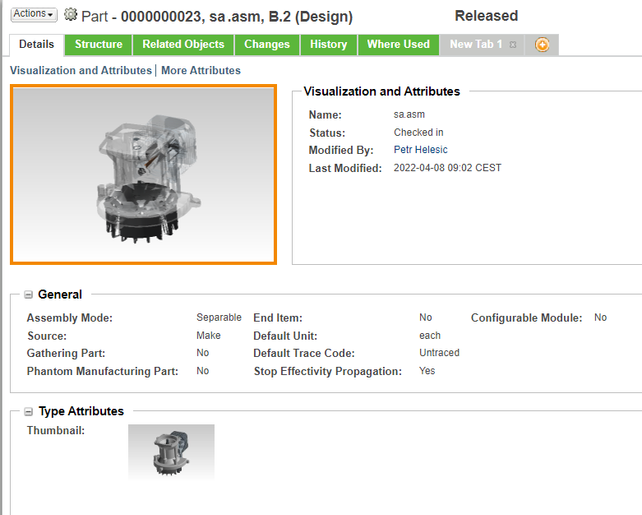

Hi @RK_10318816
Where is a problem? You share a screens that it works.
If visualization exists the thumbnail is shown ok.
If Visualization is not shown on the detail page the thumbnail can not be shown in a report.
For example,
1. Checkin CAD Document with connected WTPart,
2. Checkout/in WTPart
3. Check if the visualization is shown on the detail page. If not then this can be issue.
In my case it works.
PetrH

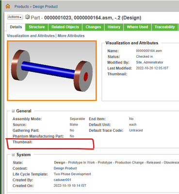

Hello PetrH,
Thank you for your reply!
Can you please tell me which version of Windchill are you using?
In my local VM, it is WC 12 and  it is working as expected.
The below one is from WC 11.2, even though we have visualization, its not showing up for thumbnail attribute.
We did not understand the root cause.

Hi @RK_10318816
Windchill version is 12.0.2.2 what I use now. But it works in others  earlier versions.
I would check the connection to a CAD Document. If there is owner link and the CAD Document is checked in together with WTPart.
If there is just image link between EPM and WTP then the thumbnail is not shown.
There is very important point. The visualization has to be the default one.

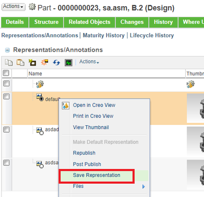

Also go to the Visualization tab on the WTPart, (you have to add it >D) and try to download the default visualization in a zip file
Check if the zip contains a JPG file. This JPG is thumbnail that should be shown in the thumbnail attribute

Hello PetrH,
There is a CAD Document attached as Owner whose representation is default, another CAD Document with Contributing Content link.'
Owner link CAD Doc's representation's thumbnail is visible in details page.
Also, the zip has both files -jpg, small-jpg. Still it is not working.
