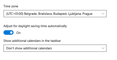

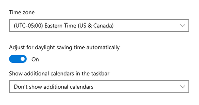

@HelesicPetr what are the settings that I need to look for on the server?
What OS do you use?
Window Linux?
PetrH
Windows server.
It shows the correct settings for my time zone
