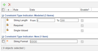

I am looking for a restriction on 'Reusable Attribute'.
1. For example, my attribute name is Test and its type is String.
2. Then i adding in WT Part, there we have a option Constraint. Right
3. Rule which i want only 3 digits required that mean i can use String Length, but i want only numberic not alphabet which constraint we can use on here.
Aj
Hi @Amirtharaj_K
You can use String format
DDD like decimal decimal decimal

Thanks for the Replay @HelesicPetr
Can you give me more details about String Format and also other types.
Aj
Hi @Amirtharaj_K
Check the help.
Attribute Constraint Rules
PTC recommends to user regular expression instead but if it works it is the easiest way how to add a format constraint.

Thanks for sharing @HelesicPetr
String Format i set 999
But if I add the String Format, box - it is so big that I can enter more than 3 numbers. However, if I finish, I will receive a notification. This method is good, but as I mentioned, we can use string length to set 3 digits. Only that much can be entered.
But the problem is both type we can enter numberic and alphabet.
Aj
If I combine both String length and String Format, it works. Thank you for your support. @HelesicPetr
Can we restrict like when we enter alpha not to fill and if it's numberic mean fill, because i filled alpha then finish i got a notification. can we restrict before fill.
AJ
Hi @Amirtharaj_K
OOTB It works as it works.
