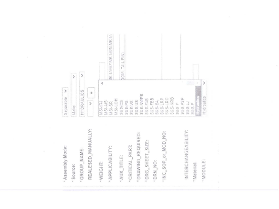

I am using Windchill PDMLink Release 11.0 and Datecode with CPS M030-CPS10
While editing the part attribute the values get merged.

Hi
Type - part.
Attributes - XXXX (Example - Material), data type - String
Constrains - Legalvalue
Image for your reference.

Hi @Nandha
You need to check the type and attribute management definition of the enumerated list
There can be some wrong definition.
PetrH
It is defined as legal value list.
HelesicPetr
(To:Nandha)
Do you use correct separator? for all values?
How many values have you inserted there?
If you use hundreds values I would recommend to use Global Enumeration list .
PetrH
we used correct separator.
100+
is that possible to overcome the issue in legal value list.

Hi @Nandha
I've never seen this situation. I would check the correct definition in the definition of the legal value list. Or I would say that there could be some limit.
PetrH
Hi
Can you check and correct type and attribute in subtype (document or part type) in organization or site utility with admin credential ,
check weather may be the attribute legal value or enumerate value then correct spacer ( | ) in between value
