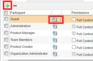

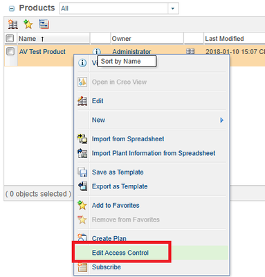

Hi @SW_369
You didn't mention if the Organization is assigned to the user.
Check the user ACL rules by the Edit Access Control
Add the user to the table and check all ACLs...

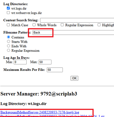

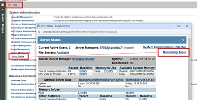

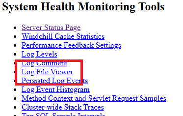

If you need to se the logs then go to the log file viewer
CS370530 - Log File Viewer in Windchill PLM
1. Go to the Site
2. Open a Server Status
3. Open Monitoring Tools
4. Open Log File Viewer
5. Select wt.log dir check box
6. Search the log files (the file name pattern is case sensitive)
in your case it is MethodServer log not the BG one.
