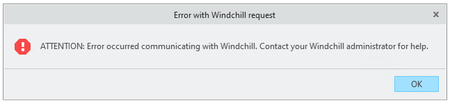

I'm running into an issue with Creo View when Windchill is configured to use HTTPS.  Attempting to open anything from Windchill in Creo View throws this error:
  • Following the steps in CS242260 to create an environment variable (PVIEW_SEARCH_ALL_CERTIFICATES=1) has no effect.
  • Following the steps in CS312299 to alter Edge internet properties to not check for certificate revocation will allow the Creo View login dialog to appear, but as soon as credentials are entered the dialog closes and Creo View never appears.  (Webserver logs do show successful authentication.)
  • The location of the users TEMP directory is not the issue. (CS347988 and CS378634.)
  • Firewalls are disabled and no anti-virus software is currently in use.
  • These are commercially purchased certificates, and the full chain is valid and not expired.
  • Creo Parametric works just fine.  It's only Creo View that is having problems.
  • This is not a cluster and there is not a proxy server.
Is there anything special that needs to be done on the client computers to fix this issue, or should simply installing the certificates on the Windchill server (Apache and Java) be sufficient?  The error is reproducible on both the server and on the client computers, and changing versions of Creo View has no effect.

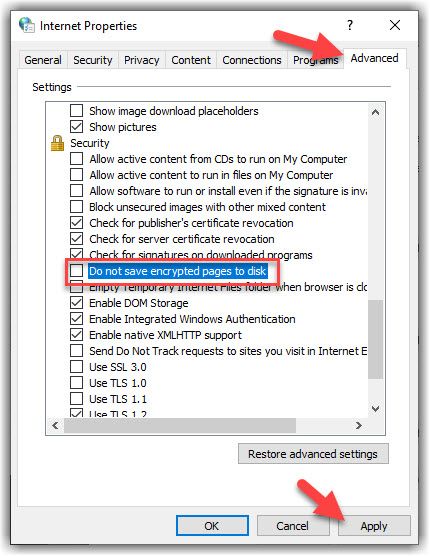

We finally found the answer after fighting this issue for weeks now.
  • Open inetcpl.cpl > Advanced Tab > Uncheck the box for "Do not save encrypted pages to disk".
Enjoy and have a great day!
