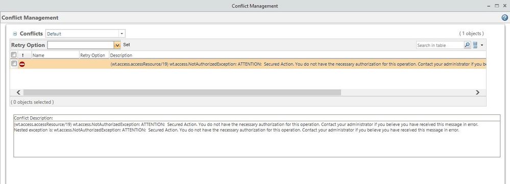

This evening, when several students tried to check out files from our Windchill server, the check out failed (and check in) and this error message came up in the Event Management console: "WTRuntimeException: ATTENTION:  Secured Action. You do not have the necessary authorization for this operation. Contact your administrator if you believe you have received this message in error. Nested exception is:
 (wt.access.accessResource/19) wt.access.NotAuthorizedException: ATTENTION:  Secured Action. You do not have the necessary authorization for this operation. Contact your administrator if you believe you have received this message in error"
Also, when I go to Open and Windchill Commonspace, nothing shows up in the folder; but when I access it from the Folder Browser, I can see all the files.
There have been no changes to the security settings, etc. by anyone on our team. Any idea what could be causing this and how to fix it?

Is the current state of the objects something that is not allowed to be modified?  For example, "Released" vs. "In Work"?  Can you attach screen shots?
Everything is currently checked in, so we can't make modifications without checking the parts out (which isn't working). When we go into Open > Windchill Commonspace, there are no files, where usually there are all our team's parts, assemblies, etc.
Not sure what you're asking for screenshots of.... Here's the error that comes up in the Event Manager. Capture.JPG

It sounds like someone changed some permissions.  This is the exact message we get when someone isn't allowed access to something (based on their permissions.)

I am in team 4293 and we have the same problem. We have contacted the administrator and he has checked that we all have permissions. Also, with no changes it was working 24 hours ago.

Yes, we're all FRC teams using the Windchill server maintained by PTC. The machine itself is clearly running, we can see files and access non-CAD content (well, I can). However, we cannot add CAD content to a workspace, and if I try to add new users to Windchill, it only lets me add them as guests, not team members. It looks as if a permission file is inaccessible - maybe it was accidentally deleted or became corrupted in some other way.
nrensing
(To:nrensing)
The server seems to be back up at this time. Thanks to everyone at PTC (and anyone else) who worked on this.
There was a problem with the server, that has been resolved now!
