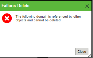

Then I went back to the policy administration tab to add/edit the access control rule to use the new role, however, all previous access control rules disappeared, and I cannot add in new ones - the create new policy button is gone, leaving only the edit, delete and list buttons as seen in the image below.
So now I have a folder that I cannot delete because I cannot see it due to the sub-domains access control rule, and a sub-domain I cannot add new rules to, thus preventing me from ever seeing the folder again and deleting it.
I tried to make a new sub-domain as I gave up on deleting it, but right after I added the new access control rules to the new sub-domain - before I even made a new folder to use this sub-domain (or any files for that matter), the same behavior happened - all the rules I added disappeared and I cannot delete it as it is referenced by other objects (Which is impossible as I just made it and haven't used it anywhere yet)

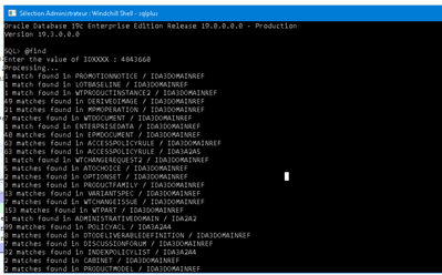

This is not a BUG , windchill tries to keep integrity ,the given domain is referenced by other objects, and deleting it will keep orphan refences ,and when accessing these objects will get a NullPointerException .
you need to run plfind (Oracle) to find what objects are referencing this objects
extract that script into your windchill folder and run it with the ID
the ID is in the log ;
run the script with that id and you will get short list of tables in DB referencing that domain :
you have to cut to business objects referencing the domain

Hi Fadel, I understand that part but that is not what I'm referencing too as the "bug". The problem is that I cannot delete the folder referencing the sub domain as I cannot edit the access control rules (create new button missing), and I cannot delete the sub domain as it's referenced by the now hidden folder (which prevents me from deleting the folder too!). This is the first sub-domain.
In my original post I mentioned that I made a second sub domain after giving up on the first one. The moment after I gave it the new access control rules, the same issue happened. It said I have other objects referenced to it when I very certainly do not as I have not used this domain anywhere yet. I thought this was the bug since how can a freshly created sub domain already be referenced by something?

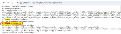

we have a workaround for this situation , we can disable the acls service and do what have to do and the re-set acls
set below property to false  , restart server , correct the acls ,delete folder ...
wt.access.enforce
Fede
