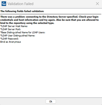

Unable to install Windchill PDMlink
LY_10691079
is it beacuse I am not able to run windchill directory server  although I am providing correct details only
lavkush.
2 REPLIES 2
BenLoosli
(To:LY_10691079)
Directory Server needs to be running first.
Check the Control Panel if the DS is running or not. Still issue persists. Cancel the Windchill PSI & Install again in administrator mode with accurate credentials.
