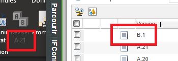

Hello Community,
We experienced something wrong with Windchill DTI :
A user revised an Excel document (.xlsm) to version B, and tried to open it with Excel, but nothing works : the file opened is still A.20 (the last iteration).
At first I suspected an issue with local files, but reproduced the problem with another account and computer with an empty cache.
We also tried to revise the document from Excel but it did not change anything : it was still version A in Excel, even if version B was created in Windchill.
I don't know if this is in any way related to the problem but in file history one can see changes in the file name and extension, sometimes "*.xlsm" and then "* (1).xls".....
I don't have much more to give as informations, I hope this will be enough...
Any idea what can be the cause of such a weird behavior?
Thank you in advance!

I had already done every step you described, but did it again juste to be sure but it still doesn't work... It even gets weirder !!!
I managed to check out both versions A and B !!
I did following steps :
- Clear cache and local files
- Revise document in Windchill
- Check out version B in Windchill
- Open document in Excel
At this step, I was asked to check out documents, I clicked "Yes", and this is how I was able to check out both versions...

Yes I know, I also tried to click "No" to the Check out message but it was not any better.
It was just to show that in any test I run, I always open the last iteration of version A. I was never able to open version B, and this is precisely what I worry about...

Getting names with (1) appended suggests that you opt not to overwrite file when you open it, and instead save it to the same folder where the previous document was stored (not removed after previous checkin).
Be warned that there's a difference to where files are placed if you 1) open the document and then check it out, or 2) check out from Windchill and then open it. Method 1 would store the file in for instance ..\Windchill\Product\TestProduct\Documents, and method 2 would store the file in ..\Windchill\Product\TestProduct\Checked Out\Documents. Inconsistent working methods may lead to unexpected results.

Hello everyone,
I finally managed to repair this file!!!
The problem was indeed due to the "(1)" and the extension ".xls" instead of ".xlsm".
Steps :
1. Open file from Windchill
2. Save as (in Excel) with the good name and good extension
3. Check in
4. Revise
5. Open again from Excel => Revision B.1 OK
I guess the original mistake came from the user but I still wonder how he was able to check in a file with a different name...
