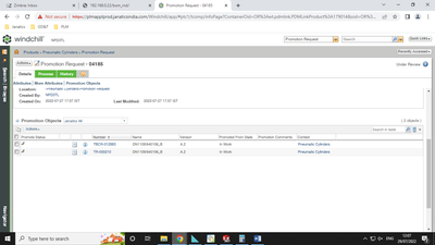

I have created two documents (123.doc and 456.doc) and attached to a promotion request.
Now the state of my both documents are changed to "under review".
I am unable to search the promotion request by 123.doc. search result returns as zero results.
But I am able to search the promotion request by 456.doc.
Both the objects are attached to single promotion request 04185
Any ideas are welcome.
Thank you.

Hi @Sathish_Rosario
Do you use Solr? index search?
If so the indexing is not finished yet or there could be trouble with indexing of the correct key words
