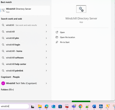

Hi all,
I have Installed Windchill DS 11.2
While Installing Windchill PDMLINK I need to Start Windchill directory server but when I open it, It automatically quit and no response neither I am getting any error
What could be the problem? I am starting it from windows search option.

BenLoosli
(To:LY_10691079)
Run it As Administrator
Be sure your account is in the Administrator group.
There is no option to run it as Administrator

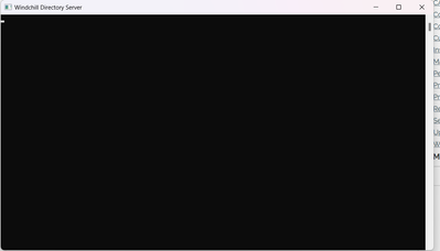

only open option is there and when I click on it opens this window
which quit automatically after few seconds.
Lavkush
Open a CMD prompt as administrator. Then run control-panel.bat in order to launch.
Scenario 1: Right-Click on Control panel.bat (DS) & Run as administrator.
Scenario 2: Check is DS is running as Services. If so stop the service & run the Control Panel.bat in administrator mode.
Scenario 3: Open CMD in administrator Account & Define the location. Later, Run the Control Panel.bat.
