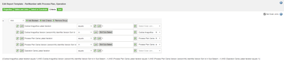

I am using Windchill PDMLink Release 11.2 and Datecode with CPS 11.2.1.7
We missed items when fetching a report in query builder. in attached picture you can find the difference between search in Windchill and export Query builder. 7 items on 15 are complely missed.

Hi Marco,
please attached you will find the picture.
Best regards
Gianpaolo
I'm pretty sure the problem is caused by a join that should have an outer join for cases where the link between tables is not true.
Marco
great  !...it seems it works ...
but in this way the result include all the history between item and process plan...
I need to have only the latest version ....
any ideas?
Many thanks
Gianpaolo
No. even I use the  process plan branch identifier the result is the same.
Report gives all the revision attached to the same process plan.
