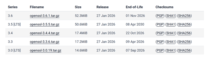

@mmeadows-3 is right. I would also note that OpenSSL 3.0 is a LTS release which is why it appears to remain the one they deploy. This is similar to PTC releases. It is possible for you to deploy your own webserver to whatever version you want and not use the PTC supplied one. Curious is the CVEs fixed in 3.6.1 are back ported to 3.0.x.
jw_CS
(To:avillanueva)
They Did already
There is a new release of every version of the series (https://openssl-library.org/source/)
But why 3.0.x and not 3.5.x?
