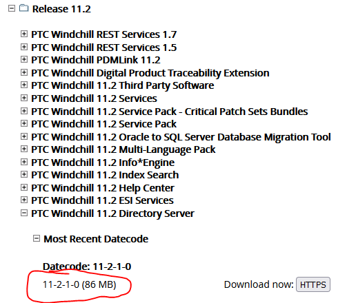

We also used the version of WindchillDS that comes with 11.2 per CS337415.  At this point I don't see any compelling reason to find a replacement.

Were you guys at 11.2 or did you just use the standalone 11.2 WindchillDS? Thanks!
TomU
(To:borourke)
This:

Got it! Many thanks!
