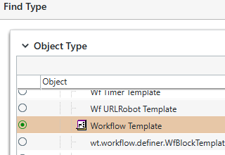

I have tried adding wt.workflow.engine.WfExecutionObject to the new product with no change.
Should I be looking at a different control type?
Which control type is for access to the templates?
Try looking for the object "Workflow Template"
But to echo what Paul said, there are better ways to manage this. You can have an object that when created automatically initiates a workflow. Some examples:
  • If you will change the design's state at the end of the workflow, you can use a Promotion Request. You can configure different workflows for different target end states (meaning different workflows to get to Prototype vs Production, for example)
  • If you just need a generic workflow, you can make a Document Subtype. If you have different workflows, you can have a different subtype for each one.
  • If you want to have a record of what objects were in the workflow, but don't want to change state, you could consider using a Baseline.
Having an object (Promotion Request, Document, or even Baseline) to manage the workflow is much better because you have a nice place to go check the status and view history afterwards.
