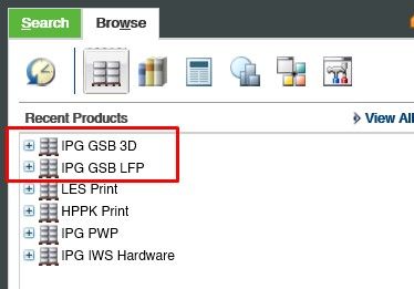

Is there any way to know or extract any kind or report listing the users that have Access to certain product?
For instance as example in image below there are 6 products folders listed, but I´m interested to know which are the users that have Access to IPG GSB 3D and IPG GSB LFP only, is there any way from windchill to extract in an easy way this info?
