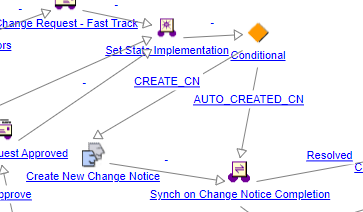

Users forgetting to complete "Create New Change Notice" task
avillanueva
23-Emerald I

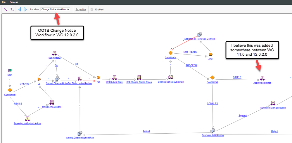

OOTB, the CR only waits on the Change Notice completion if the user acknowledges their creation of the change notice. Functionally, the process continues since the the change notice is created and the user can proceed one. I know its a training issue but the CR workflow is halted until the user completes a task and could impact resolution dates. Do others have this problem and how have you solved it?

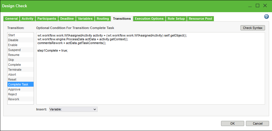

You can also build your own email notification loop.  We have these coming off each task now.
The task transition sets a variable that kills the loop the next time the timer goes off:
As far as modifying the out-of-the-box workflow, I can't imagine not having done that.   We've improved so many things over the years, and I've never had to do anything to it after each upgrade, at least not yet...

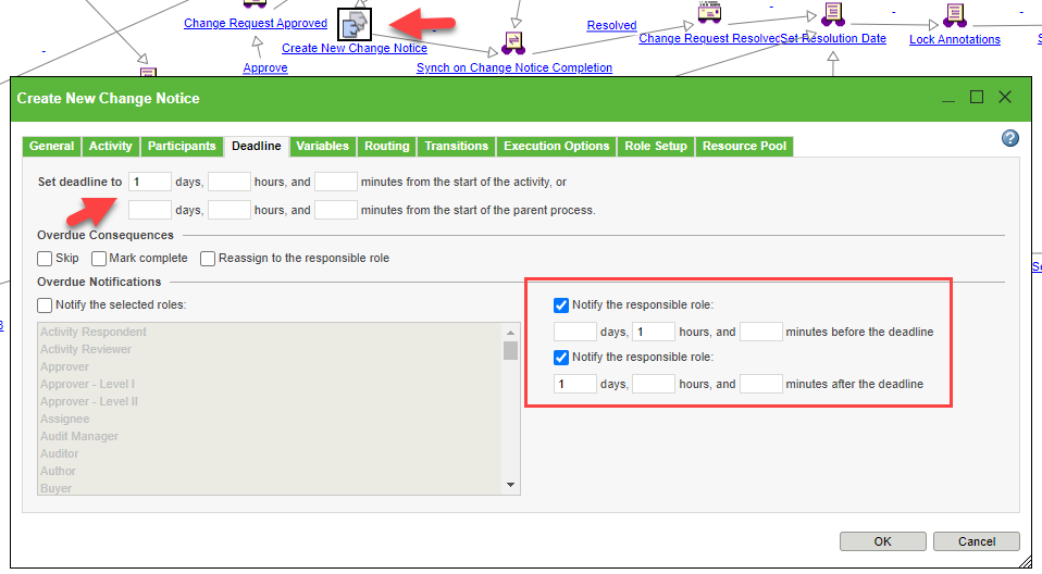

If you want to edit or copy the Change Request Workflow, you can set a deadline for the task and add reminder emails. Once the deadline has passed, the task on their Windchill home page will have their Deadline date value show up in a different color (I think it's red). Unfortunately, the max emails without additional customization appears to be 2. Per the help documentation: "Notify the responsible role—You can use these options to specify when the notification should be sent. If you do not specify a date in relation to the deadline, then the notification is sent when the deadline is reached."
The biggest downside to editing/copying a workflow is that whenever you upgrade Windchill you'll have to review if PTC made any changes to the OOTB workflow and manually incorporate the changes. You'll want to have good documentation about what you've customized.

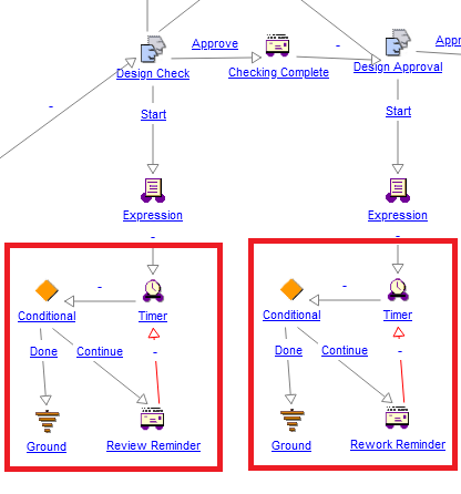

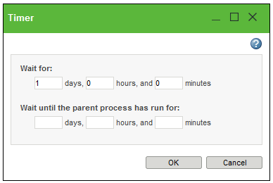

One solution I have implemented is a loop in the workflow.
The loop includes a timer robot that goes to an email robot which send the reminder email.
Include a conditional robot after the Create New Change Notice robot that will terminate the timer robot.
So, the robot the has a connector to the Create New Change Notice also has a connector to timer robot.
Timer robot goes to email robot and email robot connects (loop link) back to timer robot.
Something like that.
David
TomU
(To:lhoogeveen)

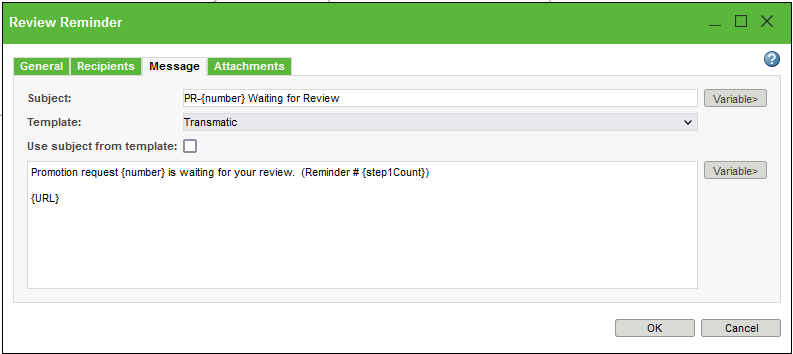

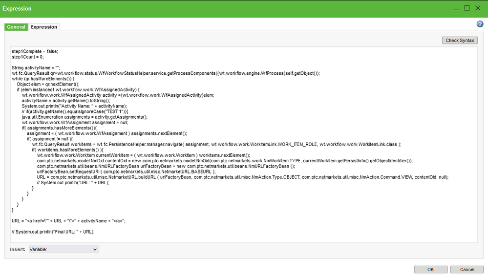

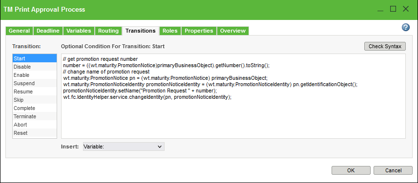

@TomU How are you building the Promotion Request {number} and {URL} variables? Having variables like that to reuse throughout the workflow would be handy.
TomU
(To:lhoogeveen)
I'm sure I just copied and pasted stuff from other community posts.  I have no idea how to manually write most of this stuff.
Number (and change the PR name)
// get promotion request number
number = ((wt.maturity.PromotionNotice)primaryBusinessObject).getNumber().toString();
// change name of promotion request
wt.maturity.PromotionNotice pn = (wt.maturity.PromotionNotice) primaryBusinessObject;
wt.maturity.PromotionNoticeIdentity promotionNoticeIdentity = (wt.maturity.PromotionNoticeIdentity) pn.getIdentificationObject();
promotionNoticeIdentity.setName("Promotion Request " + number);
wt.fc.IdentityHelper.service.changeIdentity(pn, promotionNoticeIdentity);
URL
String activityName = "";
wt.fc.QueryResult qr=wt.workflow.status.WfWorkflowStatusHelper.service.getProcessComponents((wt.workflow.engine.WfProcess)self.getObject());
while (qr.hasMoreElements()) {
    Object elem = qr.nextElement();
    if (elem instanceof wt.workflow.work.WfAssignedActivity) {
        wt.workflow.work.WfAssignedActivity activity =(wt.workflow.work.WfAssignedActivity)elem;
        activityName = activity.getName().toString();
        System.out.println("Activity Name: " + activityName);
        // if(activity.getName().equalsIgnoreCase("TEST 1")){
        java.util.Enumeration assignments = activity.getAssignments();
        wt.workflow.work.WfAssignment assignment = null;
        if( assignments.hasMoreElements()){
            assignment = ( wt.workflow.work.WfAssignment ) assignments.nextElement();
            if( assignment != null ){
                wt.fc.QueryResult workitems = wt.fc.PersistenceHelper.manager.navigate( assignment, wt.workflow.work.WorkItemLink.WORK_ITEM_ROLE, wt.workflow.work.WorkItemLink.class );
                if( workitems.hasMoreElements() ){
                    wt.workflow.work.WorkItem currentWorkItem = ( wt.workflow.work.WorkItem ) workitems.nextElement();
                    com.ptc.netmarkets.model.NmOid contentOid = new com.ptc.netmarkets.model.NmOid(com.ptc.netmarkets.work.NmWorkItem.TYPE, currentWorkItem.getPersistInfo().getObjectIdentifier());
                    com.ptc.netmarkets.util.beans.NmURLFactoryBean urlFactoryBean = new com.ptc.netmarkets.util.beans.NmURLFactoryBean ();
                    urlFactoryBean.setRequestURI ( com.ptc.netmarkets.util.misc.NetmarketURL.BASEURL );
                    URL = com.ptc.netmarkets.util.misc.NetmarketURL.buildURL ( urlFactoryBean, com.ptc.netmarkets.util.misc.NmAction.Type.OBJECT, com.ptc.netmarkets.util.misc.NmAction.Command.VIEW, contentOid, null);
                    // System.out.println("URL: " + URL);
URL = "<a href=\"" + URL + "\">" + activityName + "</a>";
// System.out.println("Final URL: " + URL);

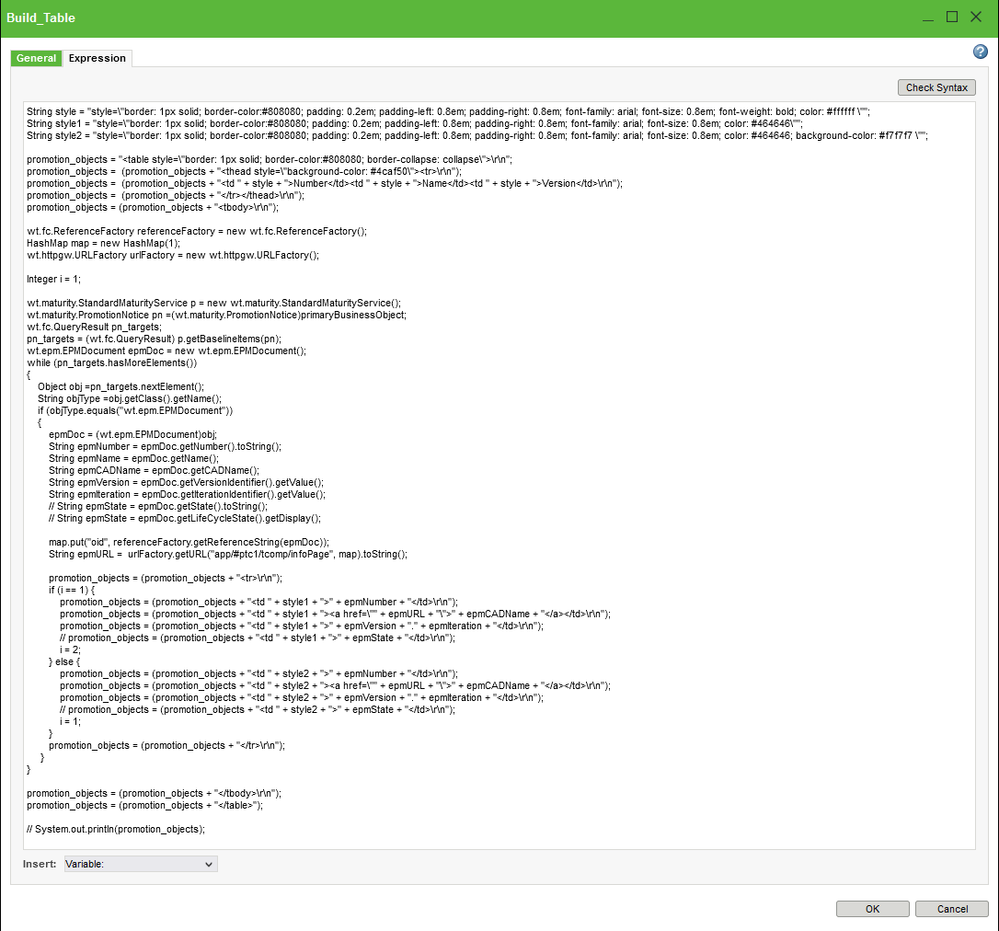

I also build (and rebuild) a table listing all the promotion objects and then include this in the notification emails.
String style = "style=\"border: 1px solid; border-color:#808080; padding: 0.2em; padding-left: 0.8em; padding-right: 0.8em; font-family: arial; font-size: 0.8em; font-weight: bold; color: #ffffff \"";
String style1 = "style=\"border: 1px solid; border-color:#808080; padding: 0.2em; padding-left: 0.8em; padding-right: 0.8em; font-family: arial; font-size: 0.8em; color: #464646\"";
String style2 = "style=\"border: 1px solid; border-color:#808080; padding: 0.2em; padding-left: 0.8em; padding-right: 0.8em; font-family: arial; font-size: 0.8em; color: #464646; background-color: #f7f7f7 \"";
promotion_objects = "<table style=\"border: 1px solid; border-color:#808080; border-collapse: collapse\">\r\n";
promotion_objects =  (promotion_objects + "<thead style=\"background-color: #4caf50\"><tr>\r\n");
promotion_objects =  (promotion_objects + "<td " + style + ">Number</td><td " + style + ">Name</td><td " + style + ">Version</td>\r\n");
promotion_objects =  (promotion_objects + "</tr></thead>\r\n");
promotion_objects = (promotion_objects + "<tbody>\r\n");
wt.fc.ReferenceFactory referenceFactory = new wt.fc.ReferenceFactory();
HashMap map = new HashMap(1);
wt.httpgw.URLFactory urlFactory = new wt.httpgw.URLFactory();
Integer i = 1;
wt.maturity.StandardMaturityService p = new wt.maturity.StandardMaturityService();
wt.maturity.PromotionNotice pn =(wt.maturity.PromotionNotice)primaryBusinessObject;
wt.fc.QueryResult pn_targets;
pn_targets = (wt.fc.QueryResult) p.getBaselineItems(pn);
wt.epm.EPMDocument epmDoc = new wt.epm.EPMDocument();
while (pn_targets.hasMoreElements())
    Object obj =pn_targets.nextElement();
    String objType =obj.getClass().getName();
    if (objType.equals("wt.epm.EPMDocument"))
        epmDoc = (wt.epm.EPMDocument)obj;
        String epmNumber = epmDoc.getNumber().toString();
        String epmName = epmDoc.getName();
        String epmCADName = epmDoc.getCADName();
        String epmVersion = epmDoc.getVersionIdentifier().getValue();
        String epmIteration = epmDoc.getIterationIdentifier().getValue();
        // String epmState = epmDoc.getState().toString();
        // String epmState = epmDoc.getLifeCycleState().getDisplay();
        map.put("oid", referenceFactory.getReferenceString(epmDoc));
        String epmURL =  urlFactory.getURL("app/#ptc1/tcomp/infoPage", map).toString();
        promotion_objects = (promotion_objects + "<tr>\r\n");
        if (i == 1) {
            promotion_objects = (promotion_objects + "<td " + style1 + ">" + epmNumber + "</td>\r\n");
            promotion_objects = (promotion_objects + "<td " + style1 + "><a href=\"" + epmURL + "\">" + epmCADName + "</a></td>\r\n");
            promotion_objects = (promotion_objects + "<td " + style1 + ">" + epmVersion + "." + epmIteration + "</td>\r\n");
            // promotion_objects = (promotion_objects + "<td " + style1 + ">" + epmState + "</td>\r\n");
            i = 2;
        } else {
            promotion_objects = (promotion_objects + "<td " + style2 + ">" + epmNumber + "</td>\r\n");
            promotion_objects = (promotion_objects + "<td " + style2 + "><a href=\"" + epmURL + "\">" + epmCADName + "</a></td>\r\n");
            promotion_objects = (promotion_objects + "<td " + style2 + ">" + epmVersion + "." + epmIteration + "</td>\r\n");
            // promotion_objects = (promotion_objects + "<td " + style2 + ">" + epmState + "</td>\r\n");
            i = 1;
        promotion_objects = (promotion_objects + "</tr>\r\n");
promotion_objects = (promotion_objects + "</tbody>\r\n");
promotion_objects = (promotion_objects + "</table>");
// System.out.println(promotion_objects);
