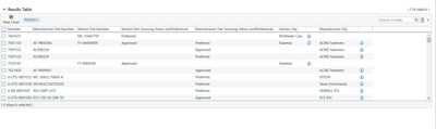

In the attached image, i have a vendor tab on wtpart page with supplier details. i couldn't able to find out where these attribute details are stored in the windchill database. i have searched stringdefinition/stringvalue tables but no luck..

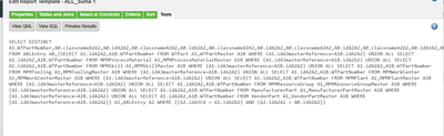

use QML in  ATTCHED  and then enable devleopper tools to see equivalent SQL
