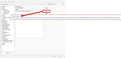

how do/can I map Windchill template folder path in Solidworks ?
Windchill path is a url path ?
our creo9 path is defined as:
template_solidpart wtpub://pdm.covidien.com/Libraries/CADStandards/Templates/MNav/startpart__mm.prt
thanks

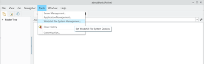

Hi @rburk you will be having a windchill file system location set on your machine, it's a virtual folder,
You can find it's location from Windchill Workgroup Manager> Tools > Windchill file system management
Browser to this Virtual folder from solidworks- PTC places/Commonspace/<your template folder>
This should set the location for the templates
Hope this helps!

 found the path, thanks
working now
