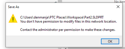

I followed the recommendation for this post. When I create a Solidworks model and save it I get this message.
Any ideas of how to resolve this issue.
Florent
(To:JamesDenman)
Depending on the version you're using, this is no longer applicable.
From 11.1, to change the WFS location, you need to use the UI:
Tools > Windchill File System Management > Windchill Folder Location
Florent ROUSSEL
