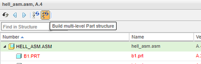

hi @Amirtharaj_K
The build action is in the right click on a CAD in a workspace
For some additional information compare the CAD Structure to WTPart, it can help you to identify the reason.
btw from the Compare to Part Structure you can build multilevel structure

hi @Amirtharaj_K
PetrH
