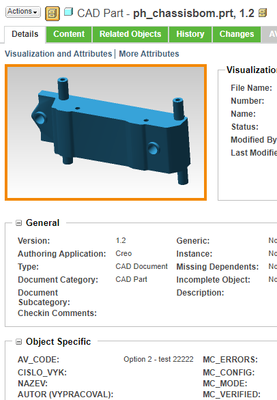

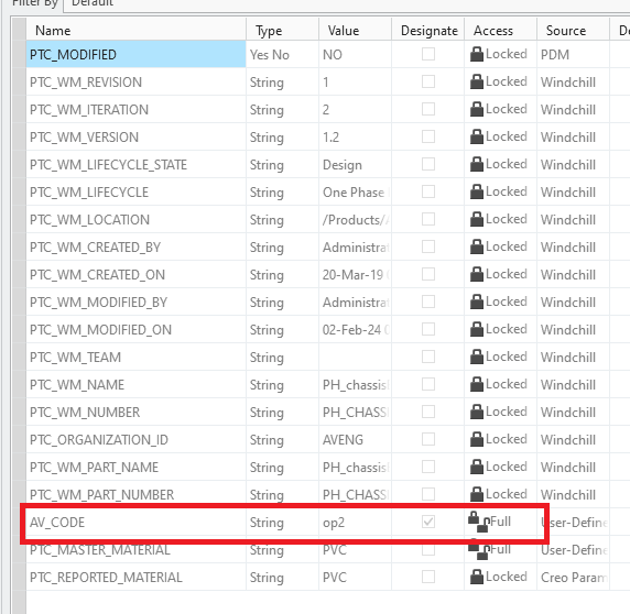

Hi @Amirtharaj_K
Here is the creo parametric parameters table screen shot
there is an internal value from the enumerated value list. So the propagation works from WTPart.

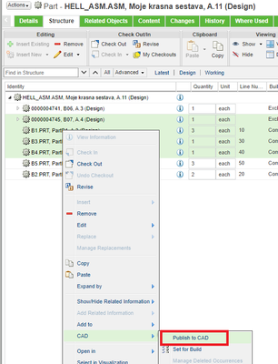

Hi @Amirtharaj_K
Yes if you propagate WTPart information to CAD Document
You just need to use Publish to CAD during check in operation
Also you can use a function from the Action menu on a WTPart detail page
PetrH

https://www.ptc.com/en/support/article/CS272669?source=search
This says that option is for publishing structure like with Top Down Design. I did not think it pushed attribute data too. Can you confirm that @HelesicPetr ?
HelesicPetr
(To:avillanueva)
Hi @avillanueva
I can confirm that the value is pushed to the CAD Document from the WTPart after publishing to CAD
PetrH

Hi @Amirtharaj_K
PetrH

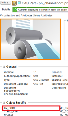

aacciano3
(To:HelesicPetr)
@HelesicPetr
Just curious,
This works only if the CAD Parameter "AV_CODE" was previously created in the CAD object, right?
HelesicPetr
(To:aacciano3)
Hi @aacciano3
No,
The previous iteration does not contain that parameter in the CAD Model.
The behavior could be affected by version of a creo  workgroup manager.
I tested windchill 12.0.2.7 and Creo 9.0.3.0
PetrH
