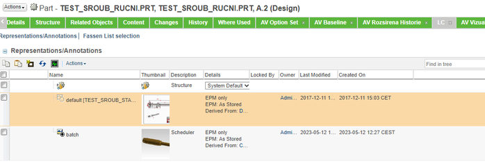

Can you see the drawing visualization on the WTPart?
It is accessible from the WTPart but the user needs the rights to see the drawing.
Also I could see that some configuration can be done that drawing PDF could be saved as a separate WTDocument with access ACL definition for other department
PetrH

How can we include that in 'Representations/Annotations'? Could you please brief me on that?
Aj
Hi
it is autamatic of the wtpart is linked with model and the model has a drawing with calculated reference
also a user has to have a rights to see model and drawing
without corect ACL you can not see it
