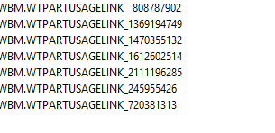

I'm Trying to migrate Non Windchill source Part to Windchill WT-Part, while trying to load the usage link Found out this
bit confused which one to use to migrate the links, I know that EPM and WT-Part has Usage Link.
While stagging wbmldr tries to check all the above-mentioned tables.

Problem was i was confused which table need to be used for populating the WTPARTUSAGELINK there are multiple tables in the stagging database.

Why there is multiple tables for WTPARTUsageLink
I found these table for WT-Part on this which one needs to be used, is there some explanation for the table names with number?
(eg:)WTPARTUSAGELINK__808787902 why this tables are mentioned with number.
Does WTPARTUSAGELINK__XXXXXXXX , the number has any specific representation on links

Who knows 😄 You could try to migrate the data several times and it is linked with each try.
Try to clean up the stage database before next try.
Also I would advice try to open a case with PTC support for a help with the data balk migration.
