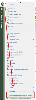

I am trying to see what is available to perform a WTPart to MPMlink Operation where used.   can't seem to find anything useful.

Try to use "Display Related Manufacturing Objects"
@nelsonpereira  Where do you find that?
HelesicPetr
(To:byork)
on detail page of WTPart
Check out this article. It might answer your question.
Article - CS350781 Is it possible to add columns to display "Attributes" of "parts", "Process Plans", "Operations" when "Display Related Manufacturing Objects" in Windchill PDMLink
Query Builder would work.
It is possible to create a Actions menu pick that will open a Report and automatically pass data derived from the object whose page the action was selected to act as inputs into the report.  This would effectively automate the running the report from the object's Info page.
