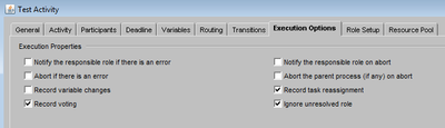

What is the use of Record Variable Changes property in Workflow?

Record variable changes Saves the variable values entered by an individual assignee in the activity.
This applies only to variables that are displayed in an activity and are editable by an assignee for the activity.
These values are captured during workflow execution for each activity instance and for every time the activity is executed
