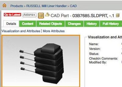

Use Case: When creating a CAD object and checking in to create a associated PART with owner links, sometimes (not always) the CAD object gets a visualisation OK but the PART is not visualising, instead it has a "open default config spec in creo view" instead of the 3D visual.
Description:
I would like to try to get an explanation to this behavior - its a little convoluted to explain, so hopefully this makes sense.
  1. create a CAD object and check in via WGM to create an auto association PART as owner
  2. the CAD object triggers a visualisation job and creates ok

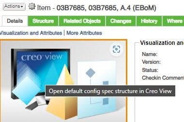

  3. the PART doesn't trigger a job and is listing no thumbnail or visual
  4. the PART has "open default config spec in creo view" instead and the content tab just list the structure

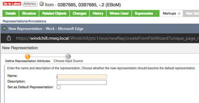

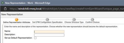

  5. If you goto the PART and try to republish - it has a different wizard and settings

The representation from the non-latest CAD object (shown above) probably isn't going to update the representation for the latest version of the WTPart.  When you look at the 'CAD/Dynamic Documents' section of the WTPart's 'Related Objects' tab, what version of the CAD object does it show the owner link to?  Is it the -.1 version of the CAD part, or something later?
RME_DH
(To:TomU)
Thanks for the Reply TomU,     I think I just had a misleading screenshot for that association, sorry.   the -.1 wtpart and -.1 CAD are associated as owner and exhibit this behavior.
So after a bit of experimenting with everything i know, setting a manual "rebuild Part from CAD" action from the CAD actions menu, seems to fix the issue for the latest rebuilt versions.    however, 99% of parts and cad are working as expected, its a just a few (maybe about 2000 out of 100's of 1000's) that fail a weekly scheduled visualisation job the seem to have this issue - from the initial check in.       This led to checking the preferences at SITE/ORG and user, and they are all set to auto associate and trigger a build action on checkin and auto associate - which explains why it works majority of the time.

It could happen if a user connects the existing WTPart to CAD and then just do a check-in of the  WTPart.
Then the visualization is not be propagated to the WTPart.
Just a Build WTPart function will do it in this case or an another CAD model check-in operation.
I have experience that sometimes the WTPart build process is not 100% successful during the check-in from Workspace and the parts are just connected without successful building and propagating information.
The reason is usually unknown but you can see it in a Compare to WTPart/Compare to CAD wizard.
Also there are many others reasons for this behavior.
Check-out/in just the WTPart without copy forward representation and so on.
