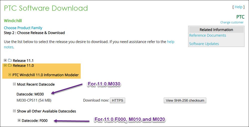

HI @eddiesengola,
You can download Information Modeller for Windchill 11.0 from below URL:
https://support.ptc.com/appserver/auth/it/esd/product.jsp?prodFamily=WNC
If you're using 11.0 M030, you need to use latest download version, else F000. See below screen capture:
As far as my understanding, Info modeler is required for annotation processing and there is no alternative to this.
For API understanding, as @Florent mentioned Windchill JavaDocs is involved in installer itself.
Shirish

Hi ShirishMorkhade,
Yes, that's what I was looking for.
Also, do you work for PTC? If so, is it possible to confirm if the **annotations processing** works without using the Info. Modeler as Florent stated.
Eddie
