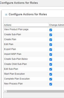

Through ACLs, you should be able to open it up to anyone you wish but check license templates as well.
Look at the Configure Actions for Roles capability under Team for the project. You have the following options for all the various Roles.
